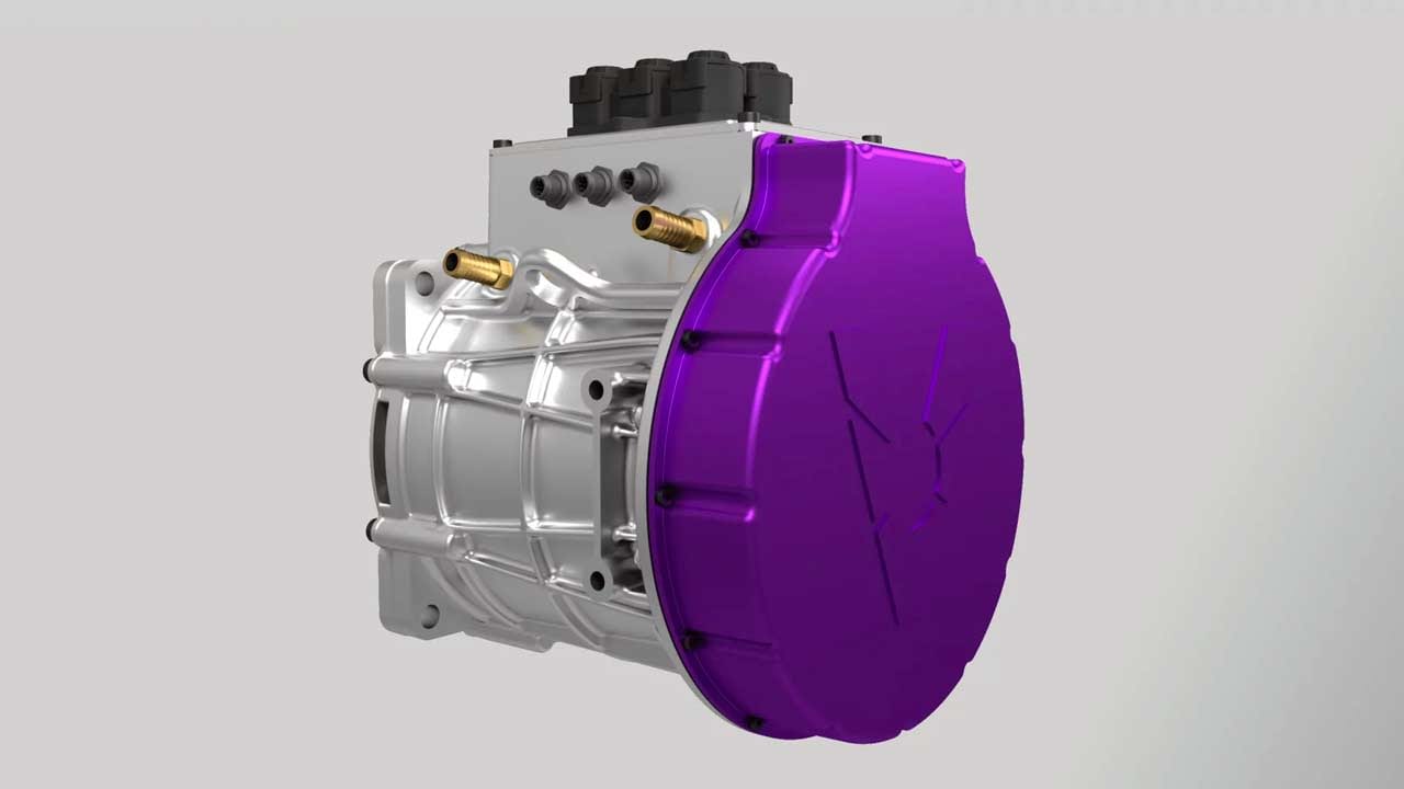

Molabo straight shaft motor
This engine, weighing only 45 kg, can produce a constant thrust of 50 kW. The device uses low voltage during operation and is therefore safer than its counterparts. Company Molabo declares that this shaft drive has a system efficiency of more than 95 % in optimum operating mode!
Chances are we'll see more and more people swap out their old smoking diesel engines for these electric powerplants. Looking forward to seeing a working model for mass use!
