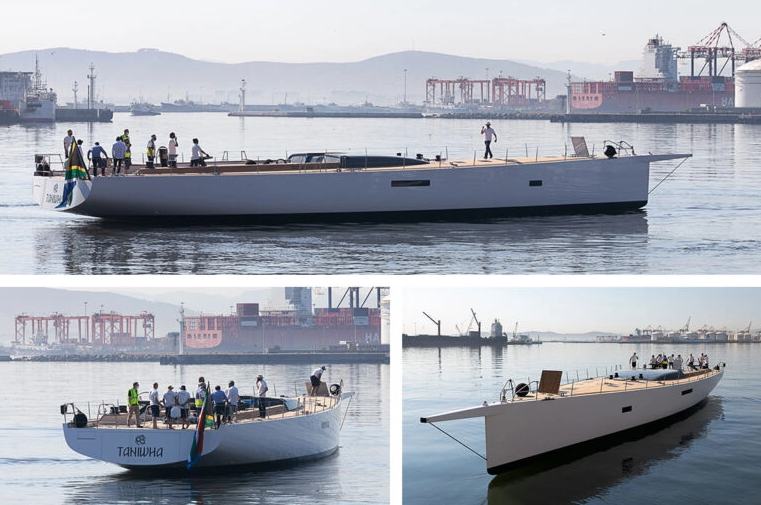

The first sailing yacht commissioned by her passionate owners, SW105#04 Taniwha was christened in Cape Town
Thanks to the owners’ input, commitment and passion, Taniwha can be defined as a “smart custom” yacht with strong character and an elegant and unmistakable style.
Taniwha has a GT (Gran Turismo) deck configuration carefully conceived for the owner by Nauta Design, also responsible for the yacht’s exterior and interior design.
“This new deck design has an innovative and clean look that is driven by the methods of composite construction and by racing yacht styling. We think that our GT design will be a successful new style because it rests on a solid base of concepts which are the expression of a pure design“, says Massimo Gino from Nauta Design.
Like a classic Gran Turismo car is designed for speed across long distances and enjoyment on shorter runs, this project is conceived as an elegant and fast bluewater cruiser that can also be enjoyed for brief jaunts.
Compared to SW105 DS and RS, this new GT version is characterized by a minimal coachroof, which gives the yacht sleek and sexy lines and a wider cockpit area on a single level. The helm positions have been moved closer to the gunwales for better views forward and aloft, allowing a generous sun pad area just below the maneuvering cockpit and a garage for a 4.2m tender.
With Naval Architecture by Farr Yacht Design, SW105 GT has a full carbon hull with her foredeck and cockpit in Nomex and pre-preg. Lightweight and with a generous sail plan, the yacht has mast and boom in high modulus carbon and EC6 standing rigging.
Taniwha shows a single rudder and an extended fixed bowsprit of 3.12m and her lifting keel goes from 3.8 to 5.9m draft. These features combine to give her a fine-tuned balance between upwind and downwind performance.
The SW105 GT is a yacht devoted to performance: to optimize weight savings the owner implemented materials that are high-tech and lightweight both in the interior and exterior. Any and all weight saving options were evaluated according to their potential contribution towards improving the righting moment and longitudinal inertia.
Deck fittings such as pad eyes, toe rails, cleats and fairleads are in titanium, as are keel head components and the submarine anchor system. Mast and boom fittings are also in titanium. The hydraulic and electric power management systems are carefully engineered and designed for a lightweight and efficient yacht.
The interiors feature Southern Wind’s most popular owner’s cabin forward. Aft of the saloon Taniwha has two cabins, an en suite VIP cabin with a walk-around bed and a second en suite twin guest cabin. A day head and studio are placed fore of the saloon. With a deep sofa and a large desk, this space can convert to an en suite double cabin. The crew area aft is an efficient working environment for five.
The owners contributed greatly to the yacht’s interior decoration where the main challenge was to keep the furniture as lightweight as possible while still allowing for the small details that make a yacht “home-like”. Particular attention was paid to choosing eco-friendly materials.
“The interior design is 100% new. It’s the result of a well-planned mixture of materials and geometries that we have developed on our most recent yachts. It’s elegant and understated but never predictable” adds Massimo Gino.
Taniwha’s crew and the Southern Wind team are now ready for an intensive month of sea trials before the yacht leaves Cape Town. We’re looking forward to seeing her perform.
Fair Winds Taniwha!

SW105 GT Taniwha, is the fourth unit of our successful mini series of SW105 blue water sailing yachts. Just like a classic Gran Turismo car is designed for speed across long distances, this project is conceived as an elegant and fast bluewater sailboat that can also be enjoyed for shorter jaunts. Taniwha can be considered a Southern Wind smart custom yacht with strong character and an elegant and unmistakable style.
EXTERIOR
SW105 GT yacht Taniwha offers a light configuration with a generous sail plan; she features a lifting keel with a 3.8 to 5.9m draft that includes a reduced bulb weight resulting in a fine-tuned balance between upwind and downwind performance. SW105 GT has a full carbon hull and Nomex and prepreg foredeck and cockpit. The SW105 GT is a fast bluewater sailboat devoted to performance. To optimise weight savings the owner implemented materials that are high-tech and lightweight both in the interior and exterior. The hydraulic and electric power-management systems are carefully engineered and designed for a lightweight and efficient yacht.
DECK
SW105 GT yacht Taniwha has a completely new deck layout, carefully conceived by Nauta Design to meet the owner’s brief. When compared to our SW105 DS and RS models, the SW105 GT has a wider cockpit area on a single level. The helm positions have been moved closer to the gunwales for better views forward and aloft.
Massimo Gino, Nauta Yacht Design: “This new deck design has an innovative and clean look that is driven by the methods of composite construction and by racing yacht styling. The end result is a fast bluewater sailboat that combines a powerful sail plan and lightweight construction with all the comforts of a blue water cruiser. Together with Southern Wind we named this new deck design “GT” as in Gran Turismo, from car design. We think it will be a successful new design concept because it rests on a solid base of concepts which are the expression of a pure design.
“The new GT design also contains a very original feature: an exclusive solid teak coming, that joins seamlessly to the hull side then bends to run parallel to the deck and looks as floating on the interior side of the deck. Its smooth outer radius creates a comfortable bench that runs the length of the yacht and that looks visually light by day, and even more special in the evening when a hidden rope of LED lights is on.”
INTERIOR
The SW105 GT’s interior will feature Southern Wind’s most popular owner’s cabin forward. Aft of the saloon SW105#04 Taniwha has two cabins, an en suite VIP cabin with a walk-around bed, and a second en suite twin guest cabin. A day head and studio are placed forward of the saloon. With a deep sofa and a large desk, this space can convert to an en suite double cabin. The crew area aft is an efficient working environment for five. The owners contributed greatly to the yacht’s interior decoration where the main challenge was to keep the furniture as lightweight as possible while still allowing for the small details that make a yacht “home-like”. Particular attention was paid to choosing eco-friendly materials.
