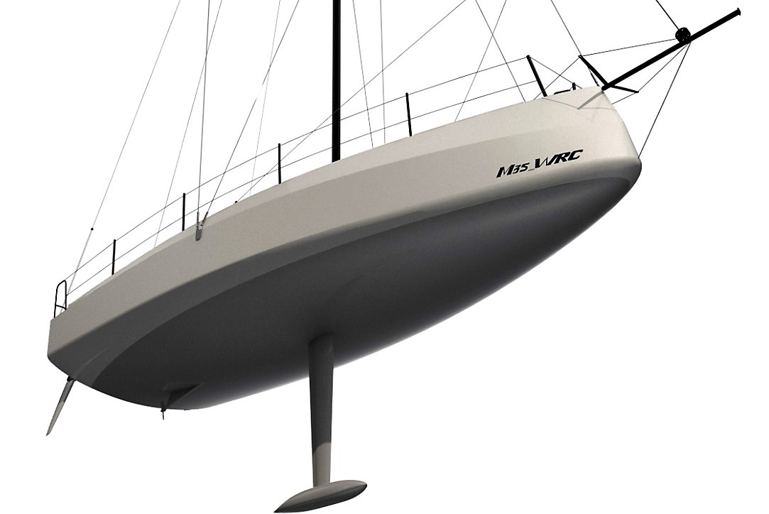

CONSTRUCTION
The M35' WRC Base version is hand laid laminated with care and precision on female molds, using multi-axial and unidirectional E- glass fabrics on high density PVC core, using vinylester resin and post cure. The light but very strong hull and deck of the M35'WRC are reinforced by a structure of composite longitudinals, floors, bulkheads and beams, involving: boat bottom, bow, keel area, mast foot, chainplates and engine. In the bow lamination it's inserted Kevlar fabric, there is a crash box and a watertight bulkhead. Aft a watertight bulkhead isolates the rudder compartment from the living area.
​The keel top has a pyramidal box shape and is interlocked in a matching case, structural with the hull. Two big prisoner are for interlocking and supporting it. All side and longitudinal loads are supported by the hull case reinforced by a grid of floors and longitudinals. The keel blade is in Weldox steel and the 1000kg bulb is lead.
​Rudders are built by e-glass/carbon/epoxy; they are external for easy of maintenance and eventual replacement while at sea. They are fitted on SS hardware. Rudders system gear is easily accessed by top openings in the spoiler. Lifting rudders are an option, they are useful for less drag and to minimize the risk of hitting floating objects.
​All big fix weights on board are placed in the centerline, to provide a better righting moment on both sides, and close to the longitudinal center to improve wave passage.
The water ballasts, 500 lt. on each side, are divided into two independent compartments, aft and central. Their shape is made to maximize the righting moment and retard the negative stability. The water is charged, discharged and transferred by an electric pump , or, sparing energy, by hydrodynamic scoops and gravity.

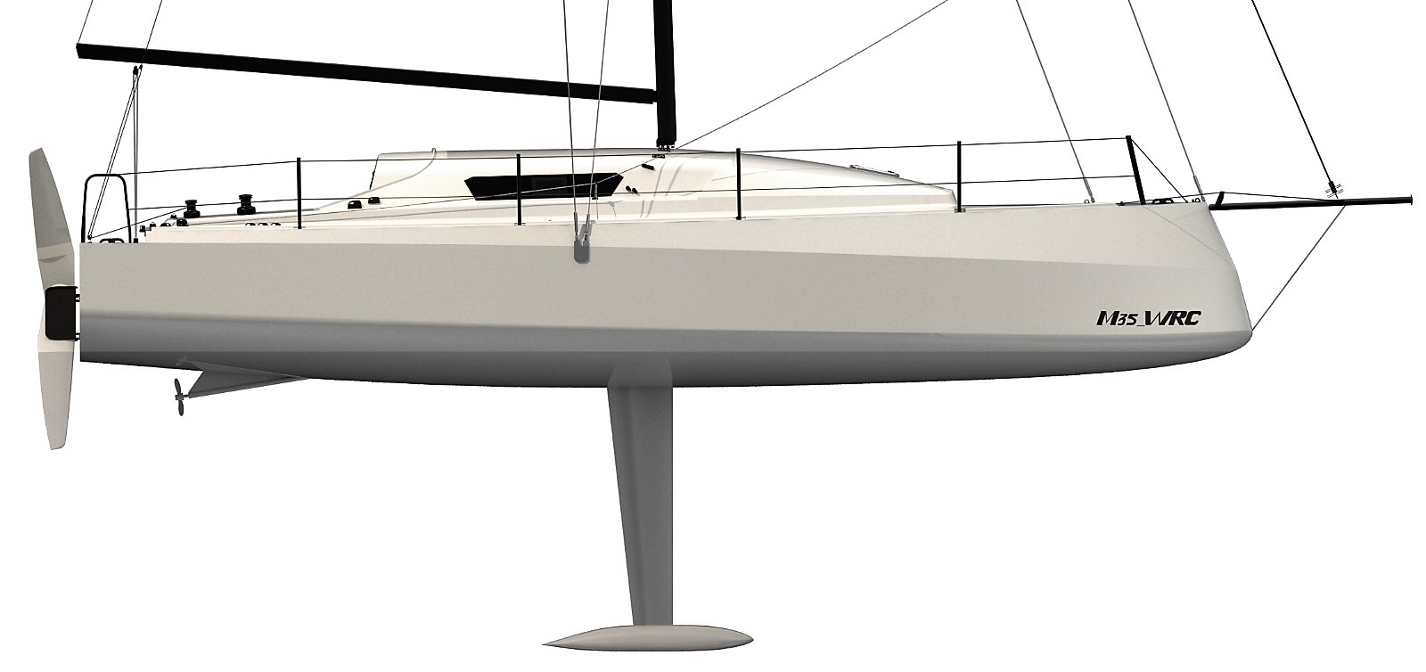

EXTERIORS
The deck has been designed to protect and give safety and comfort to the crew, to maneuver quick and easy in short crew.
The roof has an important dimension to ensure rapid righting in the event of a capsize, to protect the cockpit's from wind and spray, to provide interior height. All hatches and portholes are high on the deck and can be kept slightly open in light air without the risk of wetting the interior.
Deck plan feature Andersen ST winches and ANTAL deck gear for all maneuvers, running back stays, 2 fix vang/preventers, barbers and circuits for mast head J0 and asymmetrical spinnakers. Jib sheets points are 3D, the passageways are clear from deck gear, placed on the roof side step. The aluminum bowsprit can be oriented sideways from the cockpit.
The cockpit is deep and comfortable; the crew is protected by a canvas or a rigid sprayhood, which allow sight at the sails and at the bow.
The entrance is through a Lewmar watertight main hatch, all external lockers are under the cockpit sole and drain directly into the sea. Materials such as anchor, fenders and light sails are stowed in the sail suite, accessed by a top hatch or by the interiors, or in the two cockpit bottom lockers.
SAIL PLAN
The Velscaf aluminum self supporting mast is a 10/11 fraction rig, the single level spreaders are swept aft 25°, the discontinuous rigging is by 1x19 SS wire on bronze/SS turnbuckles on SS chainplates. The mobile staysail stay is Dyneema like the running back stays, present for safe, tuning and for mast top sails.
​The mast is placed in the longitudinal center, with the boom aft end flush with the stern, this leave space to a large bow triangle. The square headed mainsail is on ANTAL track system, 3 generous reefs reduce it into a trysail. In extreme conditions M35' WRC sail up wind well balanced, also under storm jib alone , cause the rear sail position, just in front of the mast, does not give whether helm.
​M35' WRC Base has a 110% J1 with 1 reef hand, a 110% staysail also with 1 reefs hand, a storm jib on a textile stay with it's tack at the roof end. Both front sails just need to be lowered on deck, where they remain protected and ready in their stay's deck bags.
Several rigging upgrades can be made adopting: aluminum wing mast rotating on spreaders (no outriggers), fix or rotating carbon mast, carbon boom, fiber rigging, fixed or swinging carbon bowsprit .

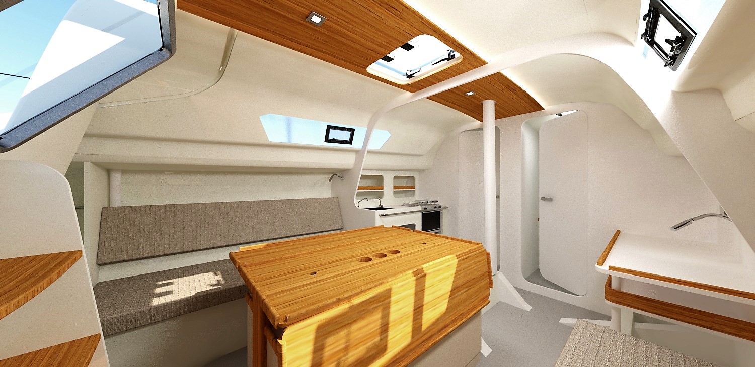

RACE Comfort
The RACE Comfort interior is for  owners spending equal time racing and cruising, or for those liking fast cruising or to compete in ocean rallyes, as ARC, and then use the yacht for tropical holidays
Saloon and the aft compartment are identical to the RACE layout with some differences:
  • Fix sofas/berth with backrest cushions and lockers underneath.
  • There is a main dining table with folding wing over the central module.
  • Kitchen stove has two burners and oven
The saloon is roomy with plenty of air and light. a folding wings dining table is fitted on top of the central case; it contain all major fix weights as: sweet water tanks, pressure sweet water pump, water ballasts system and batteries.
In the main bulkheads there are two doors. The left one give access to a double bed cabin and the right one to the toilet.
​There are wood trims on the furniture and a central roof finishing panel with integrated cabin lights.
The kitchen is equipped with a tilting propane stove with burners and oven. Over and under the kitchen top there are capable lockers for gear and food. The sink has sweet water by pressure/foot pump and salt water by foot pump. The discharge is by a manual pump, that serve also as internal bilge pump, to prevent water return when heeled down wind the outlet pipe is equipped with a siphon.
For  better light and air circulation there two windows with integrated portholes are fitted aft of the pilot bunks.
​The chart table on the saloon front right corner has an instrument panel over it and big lockers underneath. The working plan can be accessed by the front or seated on the right sofa forward end.

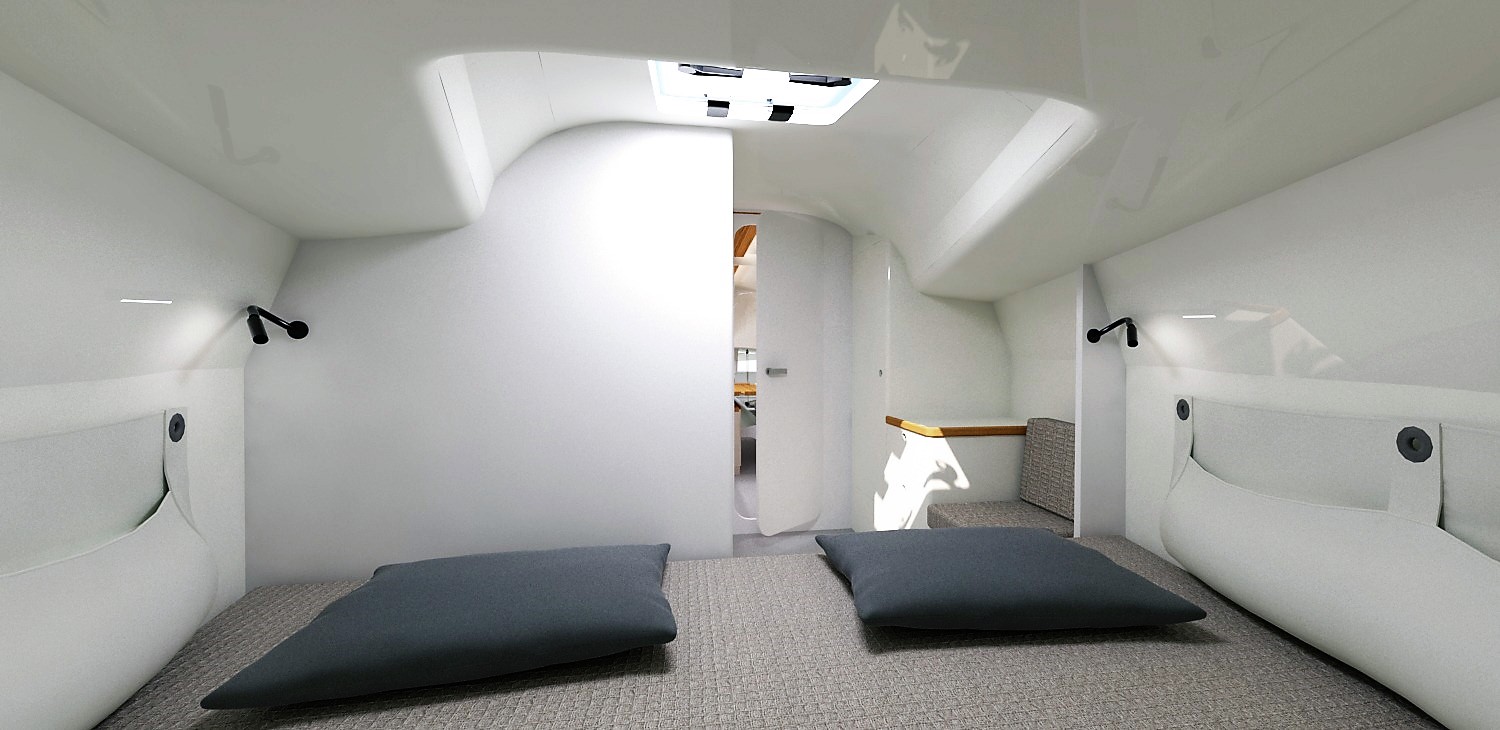

​The forward double cabin is extremely roomy due to wide M35' modern open style bow's waterlines. The cabin has a classic layout with tall cabinet, drawers and a seat on the left and forward double bed .Under the bed there is ample storage, accessible by the cooridor, for sails and sailing gear  .
​The separate toilet is very roomy. The sink is served by sweet water and placed near the center line, not to go underwater when the yacht is healed starboard. There is plenty of storage for personal items, pharmacy ,toilet and cleaning materials . Manual WC has a black waters tank that can be emptied in the water or from the deck. A shower tent protect the surrounding furniture, the water is collected and discharged by a manual pump that serve also as second bilge pump, used also to empty the forward watertight compartment.

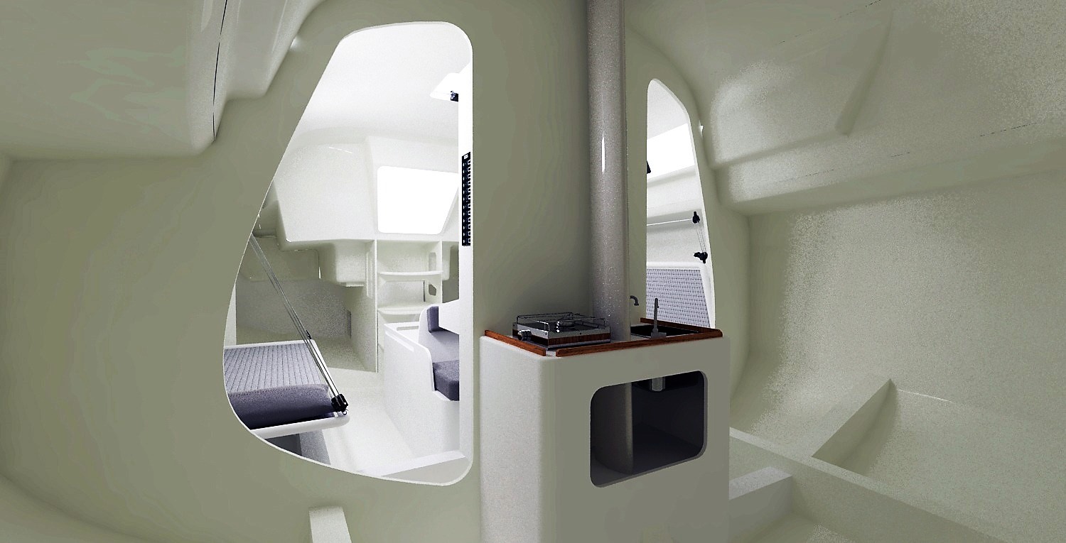

EXTREME Base
EXTREME Base interior it's the right choice to race at the maximum level as it has only a very contained furniture weight, sparing a front bulkhead, side furniture panels and floors, compared to the RACE and RACE Comfort layouts. All weights are concentrated in the centerline and in the longitudinal center. That allows larger ballasts, as all central fix weight go to windward when the healing 10° test is performed, resulting in a greater righting moment. When sailing all mobile weighs, as sails, ropes, gear, food and beverages, can be moved on gthe windside in the wall bags, over the bunks, or under them in others cloth bags if there is crew resting on the wind side.
​Complying with the main offshore race rules there are three waterproof bulkheads, dividing the yacht in four separate compartments, leaving rudders systems divided by the rest of the interiors.
​This layout feature two comfortable adjustable berth in the main cabin sides. When sailing single or double handed this two side bunks can be removed or left to store materials. In the center there is a module made by a chart table with seat placed in front of a case housing fuel tank and lockers. Placing the seat backrest between the cart table and the seat, the central module is transformed in a pilot berth. Under the central module are stored: fuel and water tanks, pressure water pump and pipe systems, ballast pump and vanes. Over it can be stored, sails, ropes or any gear that need to be at hand and that can be placed also on the two side bunks to bring weight on the wind side if needed. Batteries are stored under the chart table, in elevate position from the bottom, ths way all the electric system is cncentarted in the yacht center with very short cables..
​The galley is in the front compartment, opposite to the chart table. It's equipped with a sink and an alcohol cooker. Under the galley there is a locker for food, and the sweet water tank and his foot pump. Salt water is also present for washing and cleaning, is coming from the ballast intake by foot pump.
