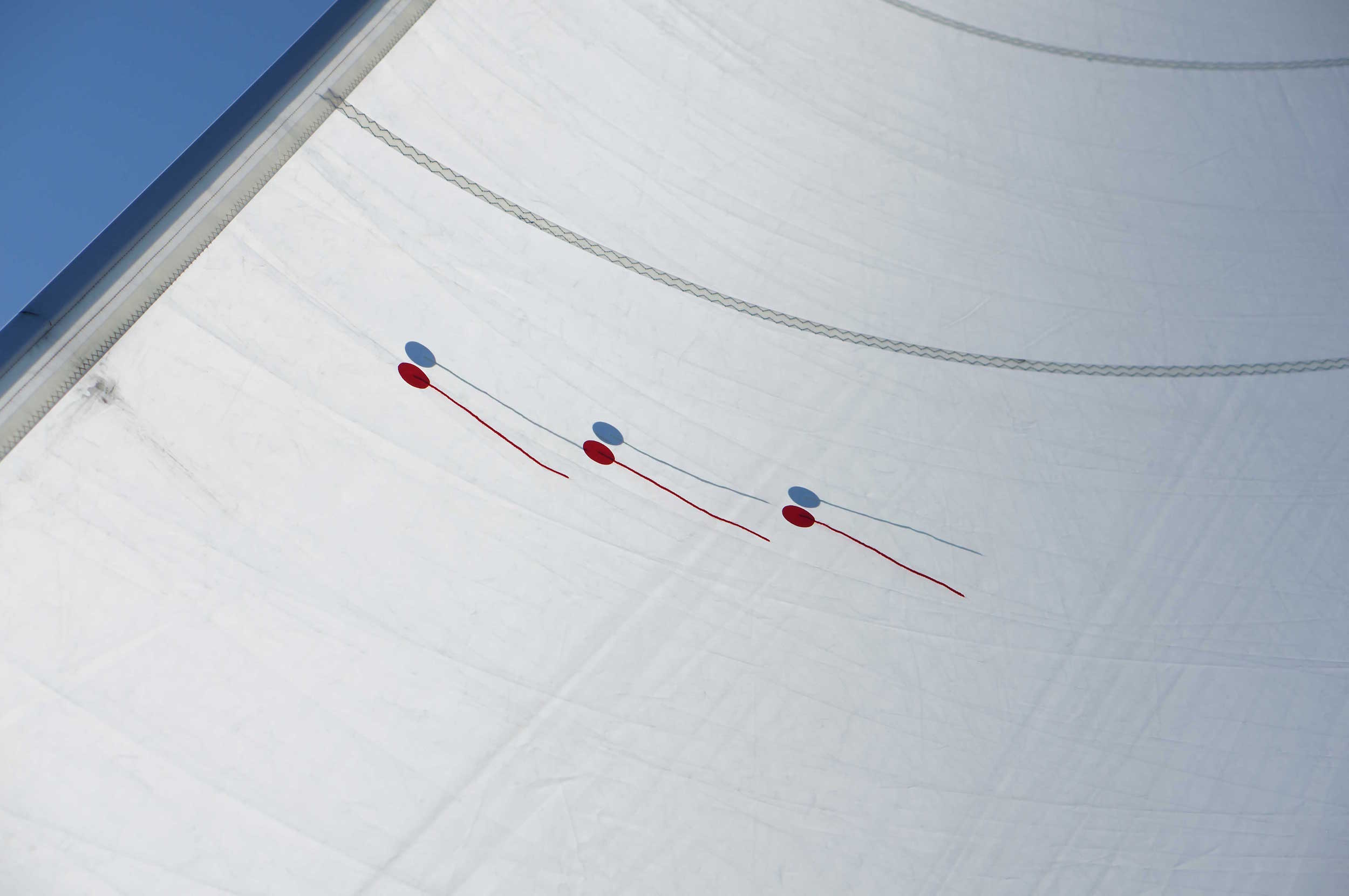

When tuning up with the good teams (or a designated tuning partner), compare your relative height and speed. In general, if you’re pointing well but not going forward, make your sails flatter. If you have speed but no height, make the sails fuller and tighter leached, especially the main. If you’re lower and slower, something, or many things, are off. Make sure you’re set up according to your sailmaker’s tuning guide, experiment with different settings, and ask your tuning partners how they’re set up if they’re beating you.

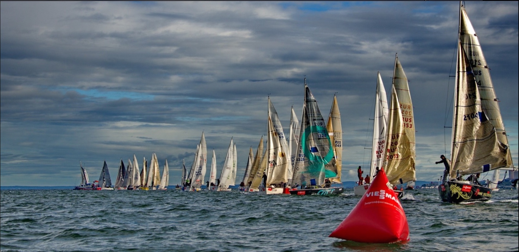

Once the committee sets the line, go back to work. It’s important to do more starting-line research than you think you should. Truly understand the whole “starting box,” as match racers call it. The starting box is the area defined by the laylines to the pin and boat ends and the actual starting line.
To get a line sight, sail to one end of the line, on the side opposite the land, and sight through the race committee flag, picking out an object on land—a building or tree, for example—that’s in line with both ends. Then, run the line using this sight to get a feel for what it looks like to be right on the line. The longer the line is, the greater the illusion you’re on the course side when you’re actually not. This is especially true in the middle. (Paul Elvström says that, because of this illusion, when starting in the middle of the line, he makes himself feel like he’s half a length over.) Get used to the feel of being on the line and trust the sight. If there’s no line sight available, use a compass heading to run the line. Find the heading by luffing up to one of the ends, inside the line, then aim at the other end to get a compass direction. Run the line sticking to the compass direction to keep you on the line. Run the line three times, looking back and forth the whole time.
During one of your runs, time how long it takes to sail from one end to the other. This will help you position your boat on the final approach. This is a great assignment to give to a crewmember with little to do.
Next, find the boat and pin laylines. You must start in between them (inside the starting box), and if you start near an end, the laylines play a big part in your strategy. To find them, set up a few lengths off the committee boat end of the line (30 to 40 seconds away) and head up on a closehauled course on what you think is the layline; do the same with the pin layline. If you’re off, do it again.
Top match racers check their starting laylines over and over again before the sequence, especially at the end at which they plan to start. This drill also helps you practice heading up (which you do in the last few seconds of the start). Plus, every time you reach closehauled, it allows you to track the wind by checking your compass angle. The shiftier it is, the more beneficial the drill.
During your starting-line research, put the bow into the wind a few times to check the line bias and to track the true-wind direction. I recently sailed the Championship of Champions and witnessed Jud Smith doing this more than anyone I’d ever seen. Jud and his daughter Lindsay won the practice race and first two races of the championship, and they did more wind shots than anyone before each start.
