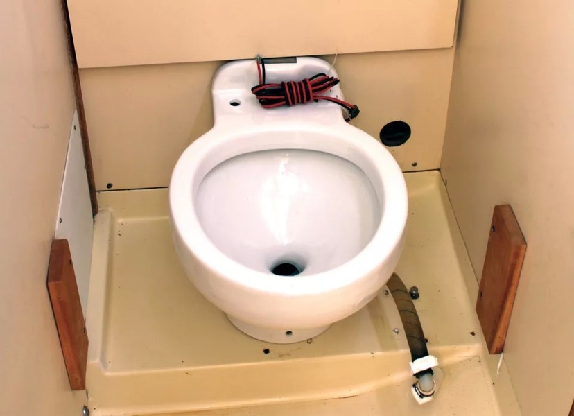

Installation was surprisingly straightforward. Since I had removed and discarded the macerator pump that had emptied the holding tank (to be replaced with a manual pump), a heavy-duty wire and circuit breaker already existed right where it needed to be. I cut a hole for the switch panel and mounted its control box on the aft side of the heads bulkhead. The cables from the two pumps were led to that box, which was then hooked up to the 20 amp circuit breaker.
The toilet came with the mounting lugs pre-mounted on a sticky template; all I had to do was position it, once I’d confirmed the toilet location, and drill the holes to bolt the lugs down. Then, using the guide supplied in the instructions, I drilled the new holes for the inlet and discharge hoses. This took some concentration, as plumbing and wiring on the other side of the bulkhead had to be moved out of the way.

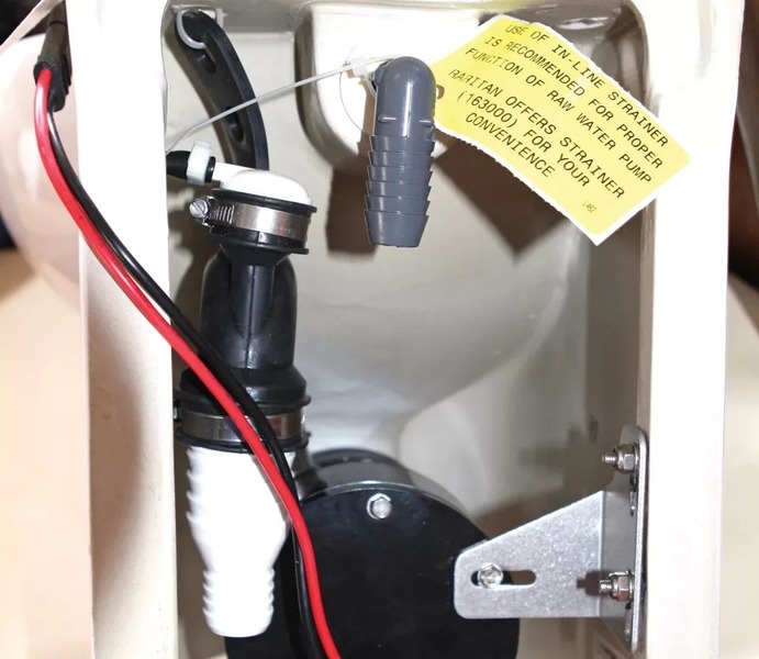

I mounted the intake pump on the other side of the bulkhead, with an inline filter and siphon break in the hose, and ran the pump’s wires to the control panel for the momentary switch as per Raritan’s excellent instructions, which I recommend following to the letter.
After installing the seat and connecting the intake and discharge hoses to the toilet’s macerator pump, I slid the bowl into position and bolted it to the mounting lugs. And that was about all there was to it.
