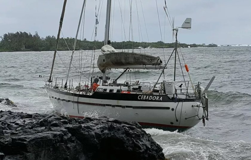

When your boat is aground, survey the situation and proceed with caution to float free
In the moments after you realize you have run your boat aground, it’s best to take a deep breath and recite The First Rule of Holes: “When you’re in one, stop digging.” Many of the steps you are inclined to take can make matters worse. You may already doubt your own skills and your decision-making. You’ll get a lot of advice, some of it noisy, a lot of it not grounded in experience. Chaos is lurking.
If it’s your first grounding, it means you either haven’t been sailing long or you’re too timid. Many veterans can tell stories that would fill an entire weekend. Few sailors have ever had to crack open the first aid kit in a grounding, but there are well-known cases of broken bones, concussions and worse. So before you do anything else, assess the status of your crew. If there are medical needs, tend to them first. It’s unlikely the boat is sinking, but faced with a choice between a bleeding crewmember and a hole in the boat, stop the bleeding first, then the leak.
Speaking of worst-case scenarios, think about leaking boats and PFDs. Make sure everyone has one, but if your boat is taking on water, don’t send anyone belowdecks wearing a PFD; it’s hard to get someone out of a boat when they’re pinned to the head liner by a flood.
Before you start an exit plan, consider what your boat is sitting on. If you’re stuck on a coral reef, imagine it’s a thousand little hacksaws on a lunch break. Sitting still, all is quiet. But if your boat starts moving around, lunch is over.
Build your plan around the least possible motion. Minimize rocking, pitching, thrashing. If there are waves, try to take advantage of a crest. It is very  important to know which is the best direction out. Logic and percentages indicate it would be best to go straight back the way you came, so if you have a good engine and your boat backs straight, take the first high crest and go. Remember, what goes up must come down, and you don’t want to land on more coral in the next trough.
Rock is second to coral as an evil parking surface. Even if the rock you are on is flat, there’s no way to know what sharp edges are nearby. Having no cushion effect, rock is more likely to loosen keel joints and bend rudder posts.
Sand and mud are cousins, and by far the most popular for grounding. Like coral, sand and mud can penalize too much commotion. If you twist and turn your keel in the muck, it’s digging in. Think of wiggling your toes in the sand. The best immediate exit is the obvious one. Your keel dug a little channel coming in. Try going right back out the channel you dredged.
